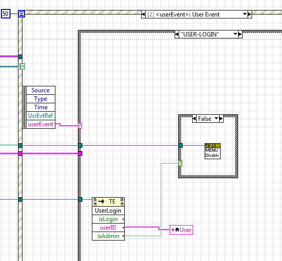

Hi, nickb,
I encounter the similar issue and hope you can give more details.
I write a Test Exective dll by C#. and using labview to call the dll. and i use [STAThread] to these form that will prompt at runtime.
Now, at program startup. the userLogin dialog prompt. it works.
and then we load some test step and run.
after finish, we click the menu to login again. but the UserLogin dialog don't prompt and the program does blocked.
I change the preferred execution model of the top vi to user interface, and then the userlogin dialog will prompt at anytime and the program don't block.
but it introduces another question. the UI refresh work badly. the UI refresh become slow.
there are some .net controls in the front panel of the top vi. we use C# code to collect test result and refresh these net controls by C# itself.
and I call the UserLogin function in the top vi.
the below is the block diagram of top vi calling userLogin function. and the C# code to call userLogin dialog.
I think that there will be two method to improve.
1, add a sub vi to wapper the C# UserLogin function and call the sub vi in the top vi.
then change the preferred execution model of sub vi to user interface,----> I will have a try.
2, modify the C# code.
but i don't have a idea now.
Hope you can give me some suggestion.

public void RunUserLogin(out bool isLogin, out string userID, out bool isAdmin)
Thread newThread = new Thread(new ThreadStart(____RunUserLogin));
newThread.SetApartmentState(ApartmentState.STA);
newThread.Start();
newThread.Join();
isLogin = mIsLogin;
userID = mUserID;
isAdmin = mIsAdmin;
[STAThread]
public void ____RunUserLogin()
UserLogin frm = new UserLogin();
WindowOwner owner = new WindowOwner();
frm.ShowDialog(owner.GetOwner());
frm.GetUser(out mIsLogin, out mUserID, out mIsAdmin);
