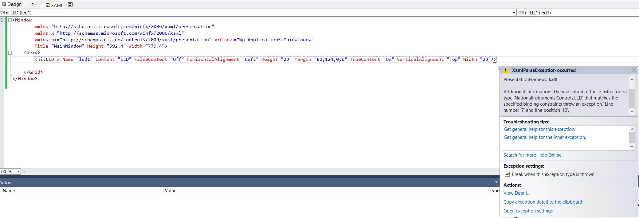

All of WPF applications shows error during running after successful compiling. Any Measurement Studio UI element (LED, Gauge, Graph.....) make error that reads "XamlParseException occurred".
"Additional information: 'The invocation of the constructor on type 'NationalInstruments.Controls.LED' that matches the specified binding constraints threw an exception.' Line number '7' and line position '10'."

Can you post the clipboard contents after selecting the Copy exception detail to the clipboard option in the exception dialog?

It looks like this issue might be related to not having created the correct .licx file. I know you went through the Using Measurement Studio 2013 for Microsoft Visual Studio 2013 KnowledgeBase article, but you may have over looked the "Using Measurement Studio 2013 User Interface Controls and Analysis .NET Class Libraries in Visual Studio 2013" section, where it links how to create a license file. The link to this file can also be found here: http://zone.ni.com/reference/en-XX/help/372636F-01/mstudiowebhelp/html/licensingnetwithoutintegratio...
We were able to replicate a similar error and creating and installing the .licx file seemed to resolve the issue. If this doesn't help, please let us know!

If you click on "View Detail" in your screenshot and look at the inner exception, that's where you'll actually find what went wrong. If it is a licensing issue, then you'll see something like
Inner Exception     {"NationalInstruments.Controls.Internal.WpfStandardLicenser is unlicensed."}
