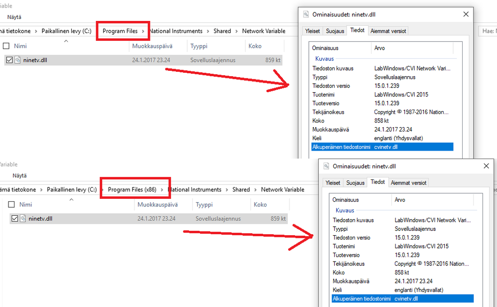

I have made a standard installation in many computers. All sw components are downloaded directly from NI web site. In this computer the ninetv.dll seems to be the exact same file in the both 32 and 64 bit folders.Sorry about the language but you see the details:
I have just Measurement Studio and DAXmx.. No LV or LabWindows. Please can you forward me the 64 bit ninetv.dll or where I can get it? The LabWindows runtime installation did not help before.

Both the 32 and 64-bit versions will contain the same metadata, that screenshot doesn't really prove anything. Regardless though it looks like you somehow got a 32-bit ninetv.dll in your 64-bit Program Files directory (assuming you correctly got that dependency walker log). I've attached a 64-bit copy ninetv.dll to this post.
