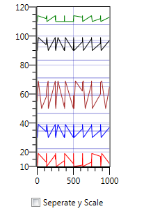

In the attached project I have a check-box which decide if the graph contains main y axis or y axis for each exist plot.
in the follow picture you can see the first screen with data :
After that, I choose the seperate check box that cause the graph disapear (because have 5 axes) - and it's OK for me.

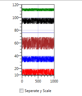

The problem occures when I unchecked the seperate check box, the data disrupted. You can see that in the following picture:
This will be fixed when you move the graph by ctrl + left mouse.
Why is it happening and how can I fix this?

I downloaded the zip file, and I am seeing the same behavior. I have an idea as to what could be the cause, but I would need more information on your solution to better find out where the behavio is happening
It seems like the code is stretching the data that is on there when you uncheck the selector box. Exactly what snippet of code is executing when you check and uncheck the multiple axis? Would it be possible to redraw the graph whenever the box is unchecked?

After further investigation, this appears to be an issue with the graph trying to re-use a subset of previously decimated data, and not recognizing the change to the plot area size when the axes are hidden.
As Shamik mentioned, the best workaround would be to schedule a refresh whenver the mode is toggled:
    Dispatcher.BeginInvoke( new Action( graph.Refresh ), DispatcherPriority.Loaded );
