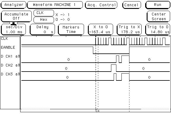

I attach an image which shows what i was going for:
As you can see, I want the data to be sent via the lines in a specific rate that is set by me.
Hopefully this will help understand me better.
Thanks again.

Have you looked at the example Cont Write Dig Port-Ext Clk?  The external clock will allow for you to control the rate.
