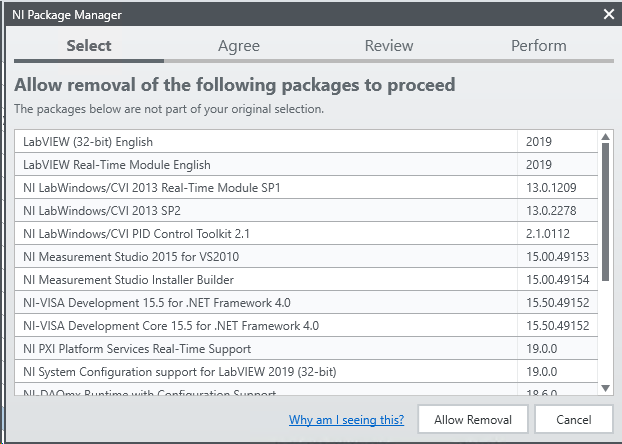

I needed to upgrade some PXI software and the installer forced me to go to license manager 4.4.  When I try to uninstall it, it wants to uninstall a bunch of other stuff.  How can I revert back to 3.7 now?
EDIT: I was able to uninstall it by running the installer program in the ProgramData folder.
