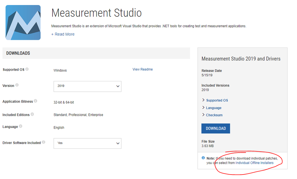

Hi Paul,
Thank you for this information. We want to try.  Could you please provide offline installer.
Best Regards,
Muhammed.
(4,241 Views)
It looks like you can get an offline installer from the Measurement Studio Download page:
~ Paul H
