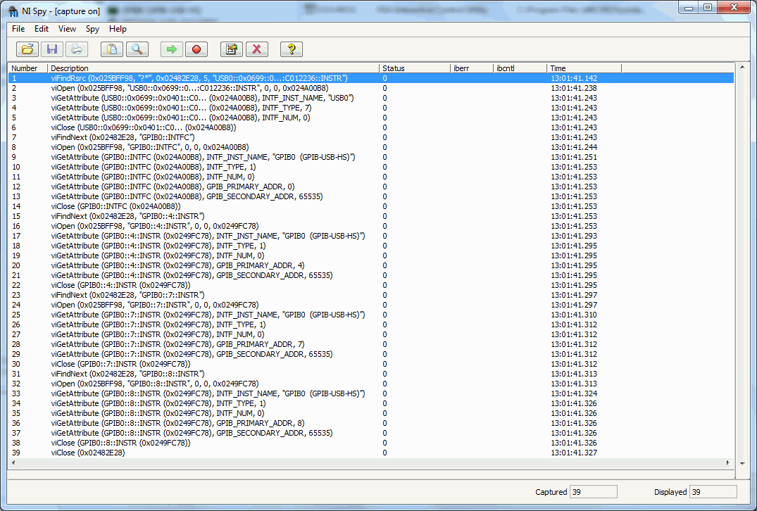

I'm having trouble finding all the resources using the FindResource method. I have 2 devices attached, one is a built-in COM port and the other is
 USB device attached (Tektronix TDS2014B).  VISA Interactive Control shows things correctly:
capture
However, in my VisaNS built application, I get only 1 result:
            string filter = "?*";
            ResourceManager mgr = ResourceManager.GetLocalManager();
            string[] resources = mgr.FindResources(filter);
resources[0] = "ASRL1::INSTR"
resources.Length = 1
I'm using NI-VISA 5.0.3 with the NET3.5 assemblies.
Any ideas?

The VisaNS interface does not give me any access to the actual arguments passed to viFindRsrc().
In addition, the Instrument_Descrption[] is an output parameter of viFindRsrc -- NI Spy is showing the result of the function call, not the input to the function call.
I plugged in a different Tek USB scope, and the same result occured: the VisaNS call did not return the USB device.
I ran the same code on 2 other machines in our lab (one running Win7 and one running WinXP), and both other machines actually did return the USB device in the call to FindResources("?*"), while my laptop did not return the USB device. It must be some configuration glitch of the NI installers, but there's no way I would be able to figure that out because it is way too complicated to figure out where the 1/2 gigabyte of install stuff went on my machine for VisaNS...
I'm still stuck.  It's going to be difficult to be able to support random devices if I don't have a programmatic way of detecting what is attached!

I do notice the following in my screen caps:
The handles of the 1st and 3rd arguments that are passed to viRscFind() look substantially different.
In the example from VISA Interactive Control, the values are 0x0x2425720 and 0x0243F898, which look like memory pointers.
In my .NET example, the values are 0x00001001 and 0x00002001, which don't look like memory pointers.  They look virtual.
In either case, I have no control over those values -- they are controlled by NI written code.
