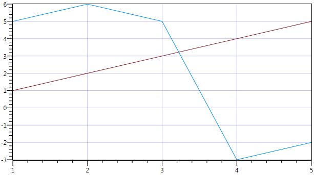

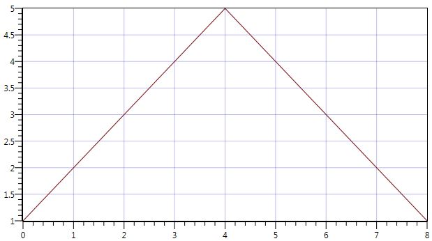

If switch is true, you see a graph that looks like this:
If switch is false, you see a graph that looks like this:
The Measurement Studio WPF graph adapts to the data source provided to its DataSource property. To clear data and replot, you can just set the DataSource to a new data source.
