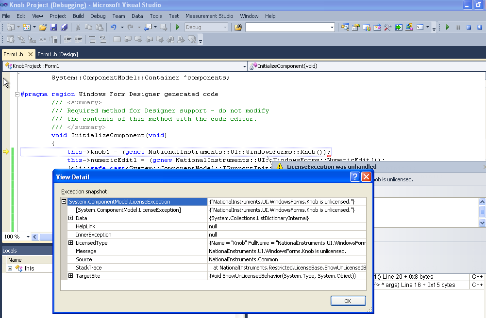

HI IM IN VENEZUELA IM USING XP SPANISH VERSION .. VS2010. ANG GET THE SAME PROBLEM OF THE GUY ABOVE.. I CHANGED THE SETTING IN THE LANGUAGE SETTING AS SUGGESTED BUT DIDNT WORK...PLUS ANOTHER ISSUE.. THIS CAN BE SEEN IN THE GRAPH ATTACHED..
BEST REGARDS
RENATO

ok. I have an idea.. given the fact that you have spanish versions of xp and visual studio.. please build a simple vc++ project with a knob or something alike and send these fiels to me ...i if i can build it succesfully i´ll check it thorughly  to se if theres a setting that could be wrong on my project properties..
best regards
Renato.
Message 19 of 24
(4,183 Views)
Renato,
Thank you for the suggestion. Previously, I had not tried to build and run a project using one of the Measurement Studio controls (knob).
When I attempted to run the Visual C++ project, I ran into the same (or a similar) error you are experiencing:
We are currently in the process of reporting this issue to R&D. This message only occurs with the evaluation (unlicensed) version. Upon activation, this message will no longer display. Thank you for bringing this to our attention, we truly value feedback like yours.
