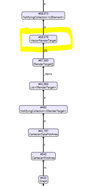

I do not see this variable in visible files, but rather through software that finds memory leaks in the system.
In order to check the leakage actually derives from NI and not from our system I created the project attached, and this variable is added all the time and never deleted.
I attached the picture of the tree that present in the leaks software, so you can see how the variable is held.
(This picture represents a variable that was supposed to be deleted).

According to the tree I've provided before: the problematic variables are in NotifyingCollection<IRenderTarget>.
I saw such list in DataPlotArea class, named RenderTargets.
Could it be that the list is not cleaned properly? or there are objects that register to events in this list that are not unregister when removed?
