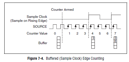

The Read is just pulling data that has already been acquired from a buffer (so it will timeout if the task hasn't started yet).  So, your counters and your AO task should update off of the same clock.  The problem you are probably seeing is that since there is no Arm Start configured, each counter will begin counting at different times.  They will be sampled together, but not armed together (see below):
To configure the counters to arm together, you will need to add the following four lines of code before you start your tasks (adjust for your actual device name):
DAQmxSetArmStartTrigType(taskHandleCtr, DAQmx_Val_DigEdge);
DAQmxSetDigEdgeArmStartTrigSrc(taskHandleCtr, "/Dev1/ao/StartTrigger");
DAQmxSetArmStartTrigType(taskHandleCtr2, DAQmx_Val_DigEdge);
DAQmxSetDigEdgeArmStartTrigSrc(taskHandleCtr2, "/Dev1/ao/StartTrigger");
This will set the counters to arm off of the start of the analog output task.  Right now they are arming immediately when they are started in software.
