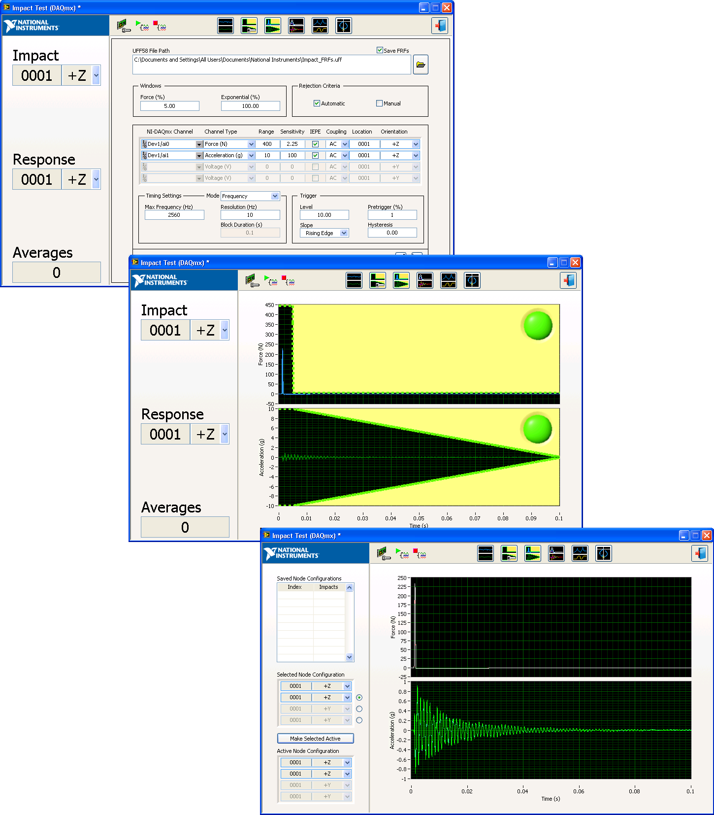

Here is a LV example that does Impact Test
Requirements: LabVIEW 8.2 Full or Pro, Sound and Vibration 2009, DAQmx 9.1
Feedback is welcome and appreciated!
Message Edited by dsb@NI on 05-19-2010 09:24 AM

above LLB was missing a typedef, and I also had a chance to fix a bug in limit test updates
By the way, if anybody has a chance to start using this, please comment on preferred behavior for saving and loading configuration. As an example, developers can always Make Current Value Default. If building an exe, would you expect a button 'Save Configuration', automatic saves, Prompt on Exit, All of these?
Message Edited by dsb@NI on 05-20-2010 11:35 AM

Hello Doug,
You've made a nice program, with a lot of practical features.
I've got only one problem: it doesn't save the measered data. The program does maken an empty result file...
An automatic save option would be excellent.
Thanks in advance!
Hans
