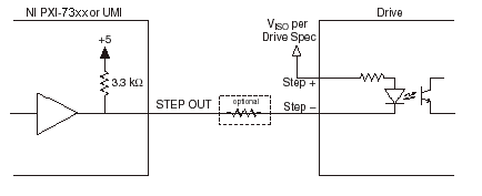

the wiring i do, for example:  for the step signal is:
ServoDrive/Step+    to   PCI7344/Axis1/Step+
ServoDrive/Step-     to   PCI7344/Axis1/Digital_ground
After you write your reply, i found in the servo manual this wiring:
ServoDrive/Step+    to   ServoDrive/+12V   (this is 12V provided by the servo drive itself)
ServoDrive/Step-     to   PCI7344/Axis1/Step+
ServoDrive/ground      to   PCI7344/Axis1/Step-
do i need to change the wiring as described in the servo drive manual/ attached here...
i think its also mentioned in one of your links.
Please, just let me know if i need to change the wiring as described here in my attached image,
if so, i assume i need to change the wiring also for the Dir signal, etc...

this is how i wire the step signal:
Figure 1-2b
this is how i nned to connect the step signal????
also in my previous post, i atached an image that shows wiring same to this.
Figure 1-2a
For each axis on the 73xx or the UMI, connect the Step, Direction, and Inhibit Out signals to the negative terminal of their respective input on the third party drive
Figure 1-2a ? Figure 1-2b ?
Message 4 of 9
(5,625 Views)
Oh oh oh ....
i think i understand something here.....
Figure 1-2b
is how i wire the step signal, at least i think its like i wire it, but this figure shows that i need to connect the
ServoDrive/Step+  to PCI7344/Axis1/Step+  and also to wire them both to +5V isolated of the UMI7774
Is that what i'm missing here?   if i understand that, the isolated +5v is the source for these signals....
in that case, i think its better to wire the step signal as described in Figure 1-2a, the one that wires the Step+ of the servo drive to its 12V.
instead of using another isolated 5V that i need to connect to the UMI7774.
Questions:
1.   do i need to change the wiring to this Figure 1-2a ?   (Step+ of the servo drive to its 12V)
2. is it ok that i use the same 24VDC power supply for both V,Viso to power the UMI ?
Thanks for your help, and sorry for writing these in some posts, i cant edit the post for some reason..
and i found more things to help solve the problem,
So,  i try to help you to help me.
JohnLv09

this is very confusing, in my last post i still have something wrong...
This is the correct choices:
Option1 (with 5VDC connected to V-iso) :
ServoDrive/Step+    to  +5V isolated of the UMI7774
in this case i need another 5V power suplly to connect to the umi, i have now 24VDC connect to the umi,
Option1 (with 24VDC connected to V-iso) :
ServoDrive/Step+    to  +24V isolated of the UMI7774
Option2:
ServoDrive/ground-  to PCI7344/Axis1/digital ground
i prefer to use : Option1 (with 24VDC connected to V-iso)
 is that ok?

Right on the UMI 7774 it has listed V-iso (5-24VDC). So long as the voltage is in that range, I don't see why any of the three options listed in the previous post would not work.

Dear Vince
Thanks for your reply.
i do this wiring:
setting the things needed in MAX and... nothing happened.
i think i have problem to set the inhibit output for the axis,
Please tell me how to troubleshoot this
i allready read all knowledgebase articles about motion...
Message 8 of 9
(5,590 Views)
This wiring that you ask here is not according to any of the figures in the Developer Zone. Which figure do you intend to use Figure 1-4a, 1-4b, 1-5a, 1-5b. The only one that uses the digital ground is 1-5b is that the one you intend to use?
