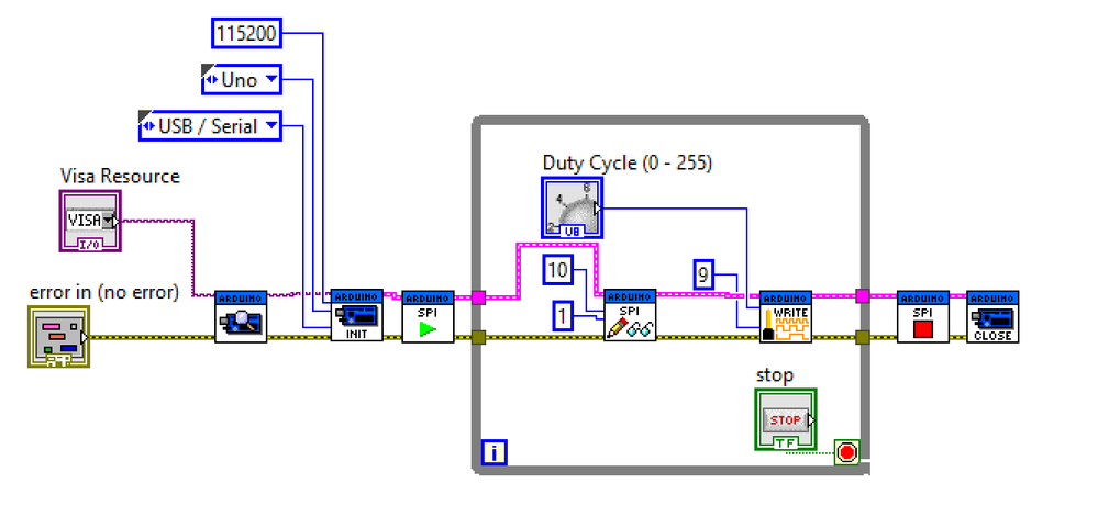

I have chosen not to use the LINX tool from Makerhub because I will eventually need to recreate this code in LabVIEW 2018 for my job and that version of LabVIEW is not compatible with LINX as far as I know.  I should also mention that LIFA_Base firmware had already been uploaded to the Arduino prior to creating this project in LabVIEW.  Starting with just the Arduino Autodetect function, the VISA Resource control, the Arduino Init, and the Arduino Close functions, run the script and get the Arduino blinking without any error messages.
The next step was to set up the SPI interface and set the digital pin used for STEP.  I also created a while loop which will continue to iterate until a stop button is pressed.  I was able to run the script, and tried running it using different duty cycles for a PWM signals to the STEP pin, but the motor has not moved.  The script appears to run initially, but when I hit the stop button on the front panel, I received the Error code 5003 telling me that the connection to the Arduino was lost.
Here is the block diagram.
The goal with this script was to be able to set the speed of the motor (using the PWM duty cycle), have it run, and turn it off using the stop button.  Am I heading in the right direction with this?  What changes could/should I make to get this to work properly?  I am very new to LabVIEW so any help or insight would be greatly appreciated.
What I would eventually like to be able to do is set the motor speed, direction, duration of run, and be able to use buttons to turn it on and off in the front panel.
Thank you in advanced for helping me.  I apologize for the long post.

I'm not all that familiar with LIFA, but it seems to me you're on the right track. We have a troubleshooting article for error 5003 that has some good next steps to take. It might also be a good idea to post this question on the LIFA forums to get more visibility from LIFA users.
