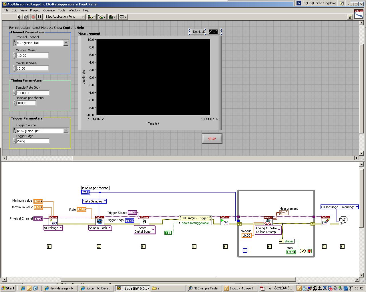

我用labview的例子Acq&Graph Voltage-Int Clk-Retriggerable.vi来在cDAQ的1槽中操作NI9206。在我运行下面的VI是出现错误信息
Error -200452 occurred at Property Node DAQmx Trigger (arg 1) in Acq&Graph Voltage-Int Clk-Retriggerable.vi
Possible reason(s):
Specified property is not supported by the device or is not applicable to the task.
Property: Start.Retriggerable
Task Name: _unnamedTask<6D>
