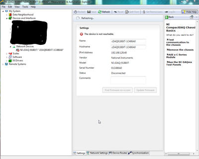

Hello,2017-07-11 13_58_16-NI cDAQ-9188XT _cDAQ9188XT-1C486A0_ - Measurement & Automation Explorer.png
I have problem with my new daq 9188xt. I see it in the MAX, but not possible set or log in this device.
This device I can also seen at NI Network Device.

I don't know where to look for a bug. It will be sure my basic error, but I don't see it.

It was by a local network setup. The device was not fully visible.
