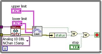

I'm not worried about exceeding the specified voltage for the NI 9234. I have an AI accelerometer that I want to make sure the input isn't greater than +5 V or less than -5 V. How do I stop the vi if the input is beyond those input limits?
(3,948 Views)
As you mentioned, since the "Overload Channels Exist" property node is not supported by the 9234, I recommend setting up a comparator statement in your code from your DAQmx read and wiring the result to the stop terminal of your while loop.
Hope this helps!
Glenn

Would I use the "Limit Test" vi to verify the limit boundaries? If so, how do I use the "test passed" boolean to stop the entire vi if the limits are exceeded? Please provide a sample vi if possible. Thank you for your patience.

Accepted by topic author jaeger10
