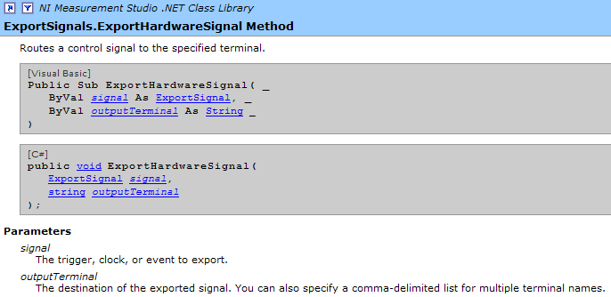

I believe you are looking for the following function:
In this case, signal would be SampleClock and the output terminal would be something along the lines of /Dev1/PFI7 where "Dev1" is the name of your DAQ device.  You should use PFI 7 since this is the direct route to the AI Sample clock on the 6110 (you can find this in the device routes tab of Measurement and Automation Explorer).

You should export the signal the way I mentioned in my other post--the 6110 hardware manual still uses the old terminology but the Scan Clock is now referred to as Sample Clock in the newer DAQmx Terminology.
You have to explicitly export the signal, the clock will not be on PFI 7 (pin 46) unless you call the ExportSignal to export the Sample Clock.
