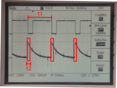

Dear All. Currently I'm using the library nidaqmx for python 3.7.4 (Windows 10) in order to acquire a single analog input channel using an external trigger. I want to acquire short pulses of data (1000 samples) at high sampling frequency (2 MS/s) and with "fast" repetitions (for example with a period of 20 ms). Please see the following diagram:
The signal on channel 1 is the trigger signal. I want to perform the acquisition on the FALLING edge. The signal on channel 2 is the analog input and I want to acquire just the portion inside the red rectangle.
So far I have been able to achieve a smooth acquisition but only for t1 larger than 60 ms using the reference trigger function and a stream reader inside a loop for acquisitions with t2 of 0.5 ms. Please see my Python code attached:

I'm not an expert in data acquisition systems but I believe that want I want to do is not extremely difficult so probably I'm doing something wrong. At the time I'm acquiring pretrigger samples but that's not a mandatory requirement. I've tried using pause triggers but with no luck.
Ideally I would only call a read function every 24 pulses because after 24 pulses I have a large stop time in the analog signal. Can you help me speed up this process? If necessary I can change the programming language to C or Matlab.

Thank you for your comment. By replacing the dynamic allocated array with a preallocated one I was able to reduce the t1 to 30 ms. It's not perfect but It's better than what I had. The time to perform:
