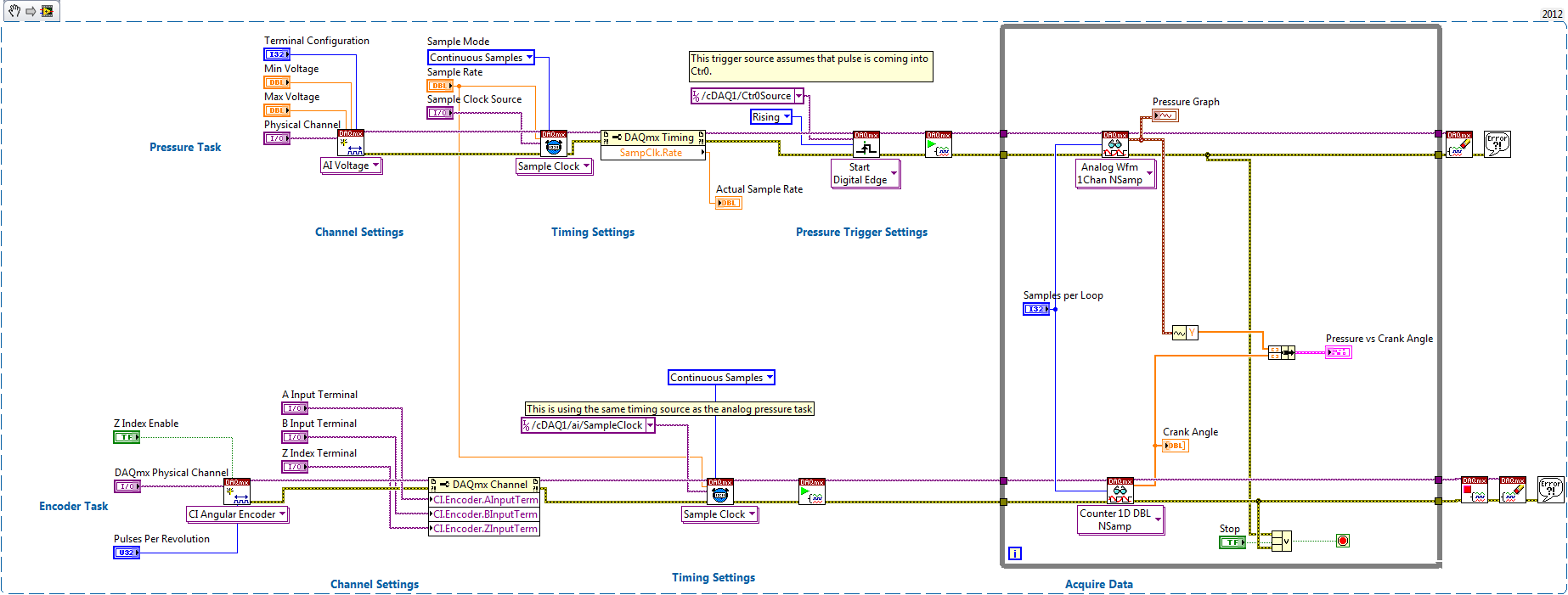

Thanks for providing the attached VI and screen shot. The error you are getting is because the clock signal coming from the cDAQ1Mod5/PFI 0 exceeds the conversion rate of the 9215’s ADC. In order to accomplish the task of getting a graph of the Pressure vs. Crank Angle, I would setup two tasks an analog input for the pressure and a counter task for the encoder measuring the crank angle. Then ensure that they are acquiring data of the same sample rate so that the Crank Angle vs. Pressure task has the same number of data points. The snippet below displays how to setup this feature.

Why is the Sample Clock source of these tasks pointed at the cDAQMod5PFI lines? In the last snippet I attached above the Pressure task was using it's onboard clock, and the Crank Angle task was pointed at the AI sample clock (the same clock the Pressure task was using) to ensure that the data points read would match up.
