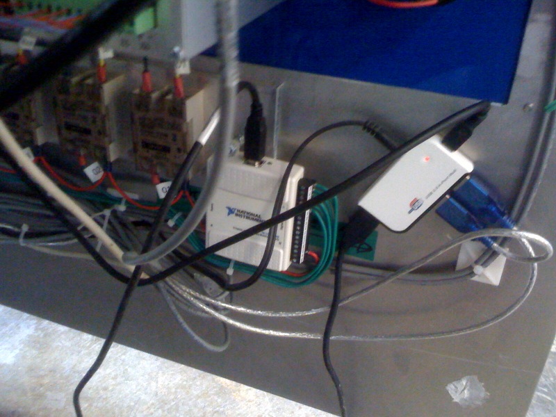

The USB 6008 is connected to a USB hub which is connected to a Win XP laptop. The DAQ communicates with the laminator (custom built) to control pressure and temperature. The recipe is written in a program called Laminator Control which is written in LabView.

There you go... there is an image of the USB being recognized.
