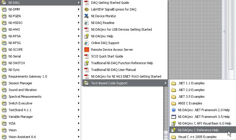

Hi Sherryl,
The C Reference Help file should still accessible through the start menu, although the location has moved slightly as of DAQmx 8.9. I would try looking here:
Start -> All Programs -> National Instruments -> NI-DAQ -> Text-Based Code Support -> NI-DAQmx C Reference Help
You should be able to get to the help as I have done in the above screenshot, but please let us know if this is not the case.
-John
