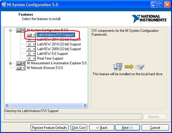

Sorry, I thought the NI System Configuration >> LabWindows/CVI feature showed up when you install NI-DAQmx (after you select "Custom"), but it doesn't.
Here's what you need to do:
  • Download NI System Configuration: http://joule.ni.com/nidu/cds/view/p/id/2613/lang/en (or select it from the NI Driver DVD)
  • Select LabWindows/CVI:
  • nisyscfg.h should be installed in %ProgramFiles%\National Instruments\Shared\CVI\include .
  • nisyscfg.lib should be installed in %ProgramFiles%\National Instruments\Shared\CVI\ExtLib\msvc . Note that it requires linking against user32.lib as well.
