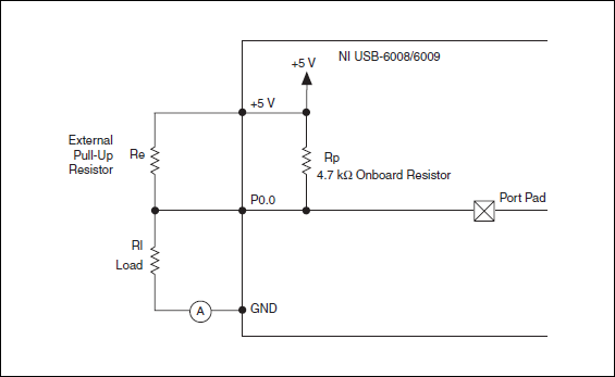

Hi Cathy,
The USB 6008 digital front end looks like this:
So, there is actually a 4.7 kOhm internal pullup resistor to 5V when the device is configured for open collector.
If you want to output 0-2.5 V, I would look into using a 4.7 kOhm bias resistor between DO and Ground (depending on the rest of your circuit).
