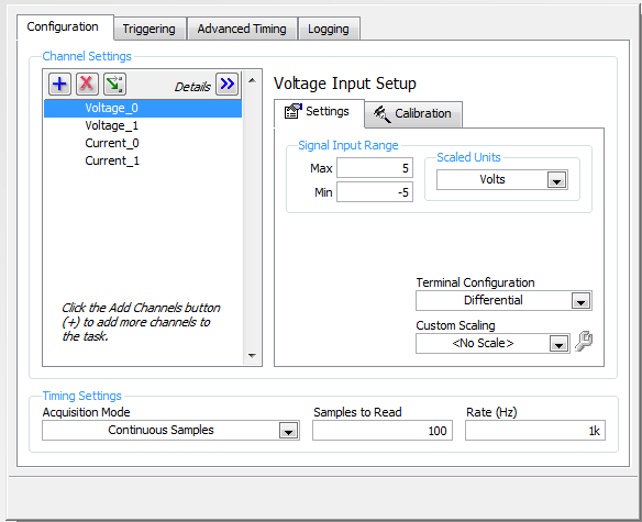

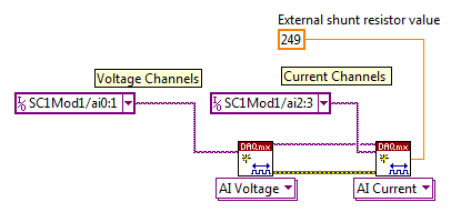

Yes it can. Although you will need external shunt resistors (I recommend precision resistors for better accuracy) for the Current Signals. The SCXI 1102B is indirectly measuring current by measuring the voltage drop across the resistor. The picture below describes the Current connection scheme as well as how this will look in LabVIEW and the DAQ assistant.
Wiring Scheme
DAQ Assistant

I would recommend a 249Ohm resistor which is the default shunt resistor value when you create a current task via the DAQ assistant or the DAQmx Create Virtual Channel (Current Instance).
