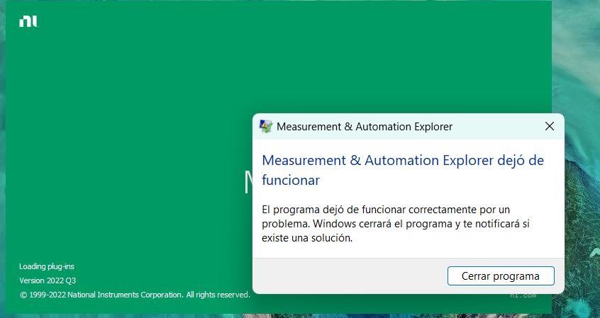

I had this problem since some days ago.
I was having trouble with other programs, and decided to re-install windows. After it was done, I downloaded the Ni-DAQmx 2023.
The installation seemed to work ok, but if I try to launch Ni max, it gives me this message:
where it says that measurement & studio stopped working, and that windows closed the program and will notify me if there's a solution (like it would ever happen).
I really don't know what is happening. I used to work with a previous version of it and everything was nice and going ok, and then it stopped working.
Currently working on windows 11.

Answering my own question here:
After a while, I decided to downgrade from windows 11 to windows 10 (with a clean install), I then installed again nidaqmx23 and it runs again without a problem.
Probably something to do with windows 11? or my machine? who knows.
