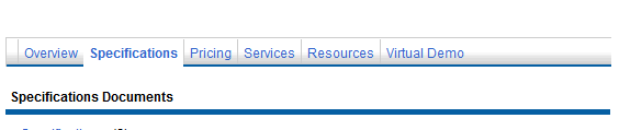

In this link: http://sine.ni.com/nips/cds/view/p/lang/en/nid/201987, you can se in the specs which is the minimun voltage range.
I hope this images help you a little bit.

BTW, I forgot to tell you, this specs are for the 6009, you have to search the model you are using!
