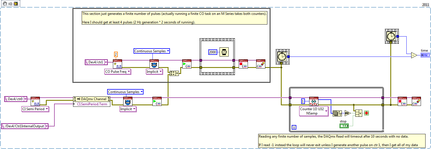

I have an application where I need to measure an indefinite number of semi-periods using a buffered counter input task on a USB M Series (6221).  Since the number of pulses is indefinite, I have made the task continuous (but a finite task with a larger buffer than my actual number of semi-periods gives the same behavior).  I start the counter input task and then trigger an external pulse generator.  I receive a signal telling me the external pulse generator has completed, and at this point I know that I can read back all acquired samples.
I anticipated that (for a low number of pulses) reading -1 would simply give an empty array as my samples would be sitting on a USB hardware FIFO and DAQmx would have no way of knowing about them (indeed this is true).  However, it turns out that reading any finite number of samples does not initiate the transfer and instead results in a timeout (even with the timeout set to the default 10 seconds).  It seems that after DAQmx Read is called an additional pulse is necessary to initiate the transfer of the buffer to software (as if there were some sort of pipeline).  However, for this application to work I need to read after the last pulse has been generated so I can measure all of the pulses.  Generating an extra pulse after reading does allow me to read back my full buffer, but I can't afford to send an extra pulse (which would trigger my pulsed-power curing system) just to read back my data.
Here is a simple reproducing VI:

Unfortunately, in this case, this is the intended behavior.  NI Signal Streaming technology allows for us to do high bandwidth applications across packet based buses such as USB, Ethernet, and Wireless.  Unfortunately, our first generation DAQ products to use NI Signal Streaming technology were based on the STC2 ASIC which wasn't originally designed with NI Signal Streaming in mind.  Counters, in particular, are a special cirumstance where it is especially quirky.  When you call DAQmx Read, we usually indicate to the device to send across all the necessary data that you've requested in lieu of creating a maximum sized packet for the best use of the USB bandwidth.  In the counter, case, however, we actually have to indicate to the device to send one more sample than you actually want.  The reason for this is that we need to manually check for error conditions on the counter subsystem before we send you any data that may be invalid.  Because of that we inject an additional step in the chain of events before the data is sent across the bus to ensure the data that we are sending is, in fact, valid.  This requires us to acquire one more sample of data than we expect to kick the subsystem into indicating any error conditions that may have occurred.
Like you noticed, this should only be an issue on Self-Powered USB M Series devices.  Bus-Powered USB M Series devices (USB-621x), X Series (USB-63xx), and all plugin devices should not have this issue.
