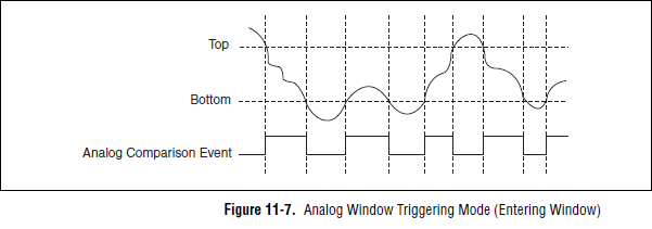

You will need to configure an Analog Reference Trigger to enable the on-board comparator.  You can use the AI line if you are just sampling a single channel (or an APFI line if you are sampling multiple channels).  Exporting the Analog Comparison Event will tell you when the signal is outside of a certain threshhold (the graph shows "Entering Window" but you can select "Leaving Window" instead):

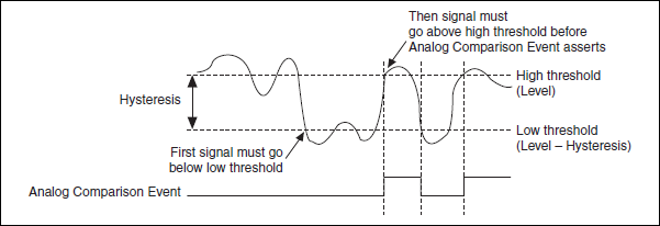

Sorry for the delay, I've been out of the office on vacation the past few days.  Did you manage to get the acquisition to trigger property?  I believe the original problem came from a misunderstanding about the relationship between hysteresis and trigger level:
So, the way you had the trigger configured in your post from 5-21, it would trigger when crossing 0V, but only after going below -1 V.  From the original post, it sounded like you actually wanted an Analog Window Trigger (instead of Analog Edge): "the voltage drops below or goes above a given value on an AI channel".
