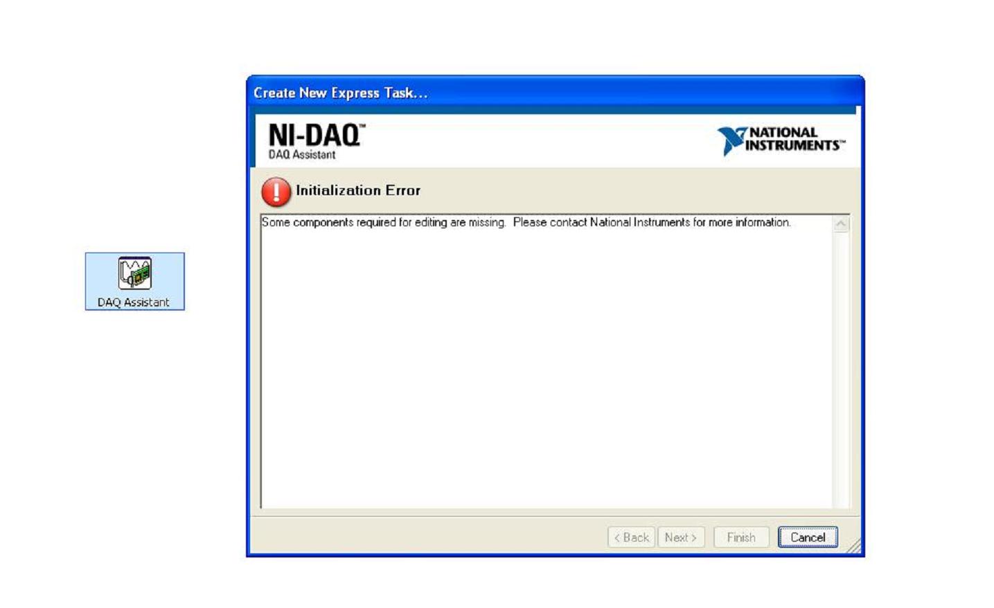

Hi Dennis
Thanks to your reply. Your observation is correct. I installed the driver, my DAQ is recognized by Windows. However, when I put DAQ assistance in the block diagram, the initialization  doesn't  work and I get an error message.

Hi
I install again LabVIEW 7.1 and NI-DAQmx-8.9. And I get the same error message: "Some components required for editing are missing.". (even if the USB 6212 is not connected)
