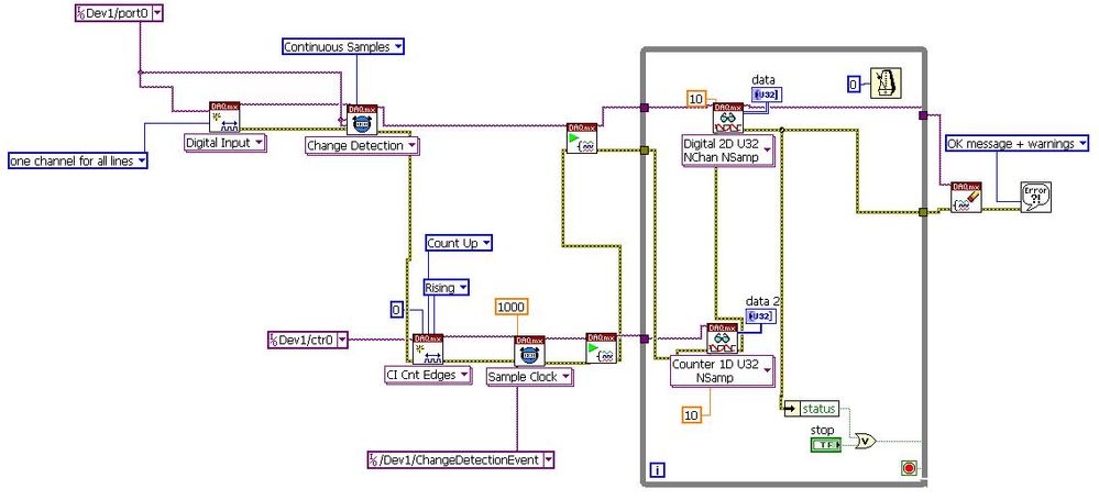

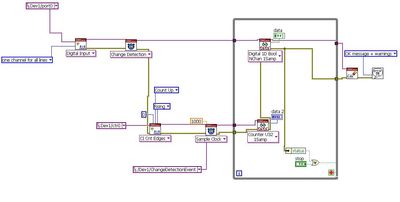

Hi Kevin,
I tried to setup the two tasks, one for reading port0 on change detection and the second one for counting the time, to assume the correct time between two detected changes.
See my vi and screenshot attached. What did I miss here, because it is not working?
Stefan
Message 9 of 11
(6,361 Views)
sorry I attached the old vi, please find here the corret one:
