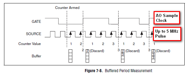

Hi John, thanks a lot for your reply, things are becoming more clear and I am feeling a lot more confident about how to go about this.
I think you understand the application quite well, but I'm posting the following timing diagram anyway, to confirm that we both are on the same page:
4x4 timing
The example deals with a 4x4 pixel measurement, and as you suggest would use buffered event counting with the sample clock routed to the counter gate to properly sort the collected counts into the right xy positions. In principle this should work exactly as you describe with no problems.

Hi Josh,
Thanks for the timing diagram--this is what I had in mind as well but seeing it on paper makes things alot more clear for us over here.  To address your questions:
1) 160,000 (400x400) or even 10,000 (100x100) would be much larger than the on-board FIFO.  Keep in mind that the FIFO is really just an intermediate buffer.  During the entire process, the data is transferred to a buffer in RAM through USB Interrupts (DMA if using a PCI device).  As long as this transfer can happen fast enough, you should be able to acquire data indefinitely.  The potential concern with our 622x and 625x is the fact that this onboard FIFO is only 2 samples long.  The 621x boards have a 1,023 sample FIFO, so although USB transfers are slower, the larger FIFO more than compensates for this and the end result is a larger sustained throughput for counter tasks.
2)  Good point, I mistakenly read that you were looking into the 6251 for some reason (probably because it is the device that I am currently using).  The counters should be identical on the 622x and 625x boards, so there is no problem here.  The analog outs on the 622x differ from the 625x, but not by much--you can check the spec sheets for more details, both are capable of the rates you require.  If you are going with a 622x, you might want to look into the 6221 since it also has the 2 Analog Outputs that you require and identical counters.
3)  This is true, the transfers will be system dependant--the benchmarks are a bit out of date, so it could be entirely possible that your system will exceed the listed value.  Keep in mind that the benchmarking was done with no other tasks transferring data over the PCI bus, so I am not positive how the AO task will interact with the counter measurement.  This was the reason I had recommended the 6218, but the 622x or 625x boards are certainly a possibility.  I believe our new hardware should have a 30-day trial period, so if you need some of the other features of the 6221 or prefer PCI form-factor this would certainly be worth looking into.  The 6251 also comes in a PCIe form factor if you are interested in this.
4)  Not a problem at all, it's common to have questions with sample clock vs. source etc. (especially when talking about counters).  Your timing diagram is appropriately labelled, so it looks like you have a good idea of what is going on in the hardware.  Your LabVIEW code would look something like this to configure the tasks:
The typical idea of a period measurement is that you use a known timebase to measure the period of an unknown signal.  Here we are essentially doing the opposite, so the terminology may be a bit confusing.
-The Counter Input terminal in this case is the analog output sample clock.  We are measuring the "period" of this signal in terms of ticks of the "timebase".
-The "timebase" in this case is not a timebase at all, but rather the external source that we want to count edges of.  You can route any PFI line to this.
-The AO Sample clock is created on the board for you.  So, here you would specify a rate.  By not connecting a source to the AO sample clock, you will by default use the internal AO Sample Clock--this is a divide down from the 20 MHz timebase on the M series boards.
-On the Counter task, we actually use "Implicit" timing.  This is because the sample clock is actually the signal we are measuring.  That is, upon each period on the Gate, we will report back the amount of "timebase" ticks that occurred.  There is no need to configure to use another sample clock (and indeed it is not possible to do so on a 622x or a 625x).
I chose to start the AO task after the counter, so the first edge of AO sample clock will latch in the first value to the buffer of the counter.  You should typically ignore this value, since the value is essentially meaningless since the counter is started non-deterministically in software (see the timing diagram of my last post).  The 2nd value in the counter input buffer will give you the total number of ticks that occurred in between the first and second AO sample clock edge.

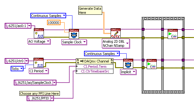

Hey Josh,
Since I already put a basic configuration together, I figured I would flesh it out a little bit to see what rates I could get on my counter input.  The attached code functions consistently up to about 200 kHz on my Dell Precision 380.  I am using a PCI 6251.
The example is by no means complete code, but it should test what I was concerned about earlier.  I am writing the 160,000 points to the output buffer, so even though all the data is 0 the transfers are still taking place from the computer to the 6251 while the task is running.  Again, the transfer rate would be system dependant, but I just thought I'd share the results I was getting for a point of reference.
I am not doing anything with the counter data other than updating a graph, you would probably want to write to a file or something of this nature.  You would also need to build the raster pattern to output on your two analog output channels.  Again, this is not polished code by any means, but I thought I would go ahead and post it anyway since it might be helpful for you getting started.  Let me know if you have any questions!

Hey John,
you've gone above and beyond the call of duty here, since you're sending me code even though we have yet to give NI any money!!  I really appreciate your help with this, and I think that it will likely work out well with the single device.
I'm relieved to see that your code is much the same as mine was, so we must be on the same wavelength.
At the moment I'm running a simulated 6229 (in a Virtual Machine, no less, since the acquisition computer has yet to be built), and am therefore ill equipped to really verify whether the code works properly - I'm getting a timeout error (-200284) on the first iteration in the loop.  It runs if I reduce the number of samples to below 10k, but runs quite slowly.  I'm sure that this is due to the hokey way in which I am running the code, but it brings me to a query I didn't mention before:
In the loop, you have set the Counter Read vi to grab 20000 samples each iteration, and you have left the "samples per channel" terminal unwired in the counter's Timing .vi.  Can you explain the significance/difference between these two values?

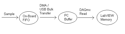

This crude Paint drawing might help clarify how these parameters fit into the application:
If any of the buffers overflow, DAQmx will report an error.  The transfer across the PCI/USB bus takes place automatically as data is being acquired, so you would just need to make sure that you are pulling data fast enough from the PC Buffer so it doesn't overflow.  This is typically only a concern for Continuous tasks.

John, that's a really helpful explanation, thanks a lot. I am curious about the FIFO->PC Buffer step - is there any way to ensure priority of this task above other processes, or does one simply hope that the USB controller is smart enough to handle things?  Does USB 2.0 vs 1.1 make a difference?
