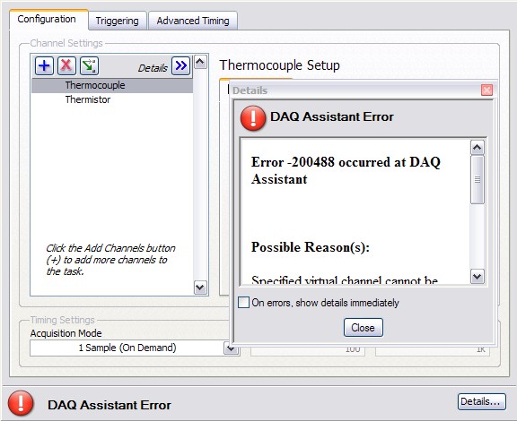

Great question.  This error is usually a result of the local virtual channel that is used as a CJC channel appearing after the thermocouple channel in the channel list.  For example, I was able to generate the same error when I put my CJC channel (which I named "Thermistor") after my thermocouple channel (which I named "Thermocouple"), as shown:

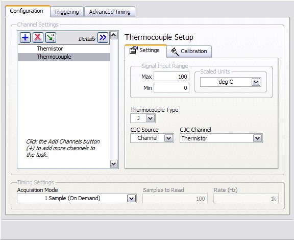

When I put the "Thermocouple" virtual channel after the "Thermistor" virtual channel, the error was resolved, as shown:
Rule of thumb:  You always want to put the CJC virtual channel (in this case, "Thermistor") before the Thermocouple virtual channel in the list of channels.
