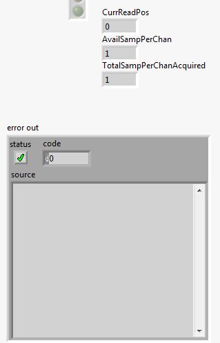

Here is a screen shot from the exe.  Notice how available samples is only 1 but I get an error.  I have other DAQ tasks running, could they somehow be interfering?
First change successful.  Only 1 available sample and 1 total:

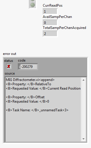

Second signal not - it is detected but available samples is 0 but the total has incremented:
My digital lines are Port0\0:4
They start a linear encoder daq task on Counter 0.  Could that somehow be interfering?  Does the Linear Encoder option allocate other resources that are conflicting?  I guess I still do not understand why it works in development and not in built.....

Strange.  Dunno about diffs between Executable and Dev environment.  But certain things about the front panel seem kinda like what you'd see if the buffer size were set == 1.
I'd be leery about calling DAQmx Read 1Channel 1Sample for a buffered task.  Anytime I have buffered data acq task, I always read "N Samples", even if I set N==1.  I don't *know* if the former would be a problem, but it's a point of suspicion.
You haven't identified your data acq hardware.  If it's an M-series (or probably also an X-series board), I would not expect other DAQ tasks to interfere with the change-detection capabilities of port 0.   I know less about cDAQ chassis' and modules, but I think things get dicier there regarding the total # of clocks available to be shared and stuff.
When you say "THEY" start a linear encoder task -- who are THEY?   Do they start it both for the Dev and the Exe?  Can you have them not start the task to help you diagnose things?

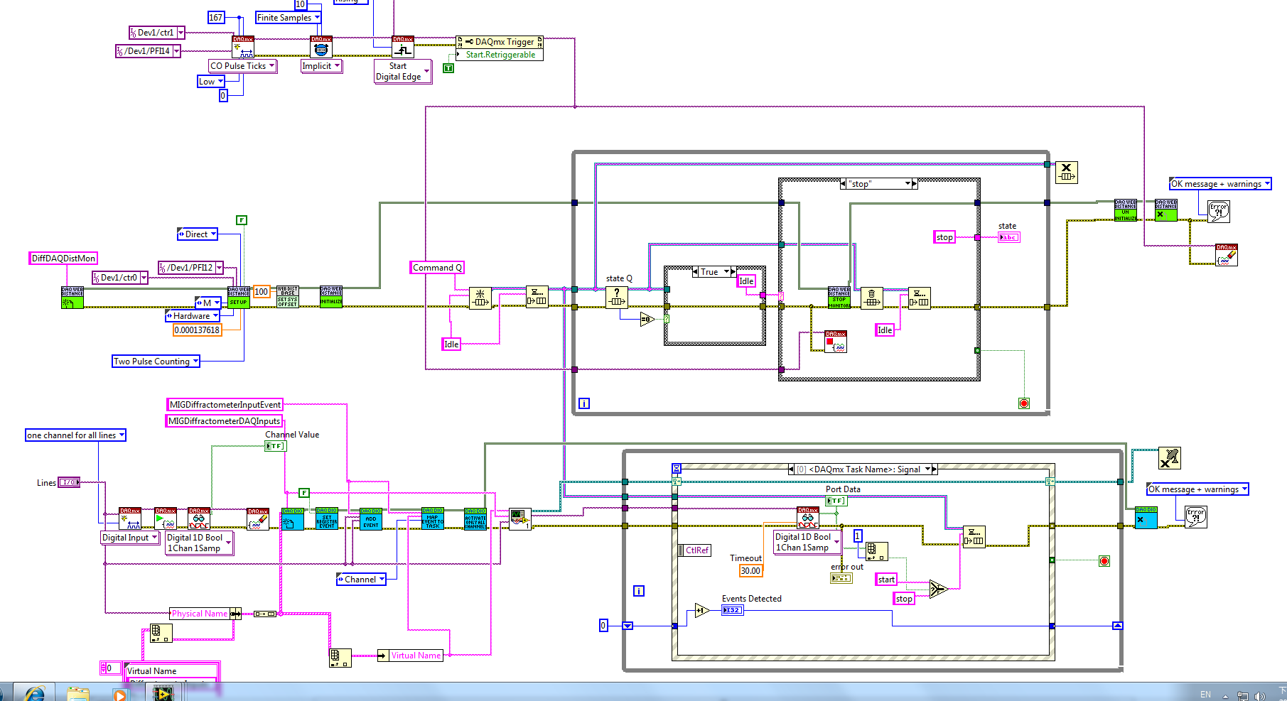

Here is a snippet.  I made a simple test using parts of a larger program.
The top task outputs a pulse that triggers a camera.
The middle section of code is a counter task that reads an encoder position
The bottom code is the IO event change.
This simple piece of code works both in development and in EXE.  My larger program still only works in development.  I get buffer overflows for the encoder read and the DIO read in the event case when in EXE mode.  Since it always works in development mode I have no idea how to debug this, especially when I pull out the pertinent pieces and it still works in EXE mode.  Maybe I will open a service req.

Any progress?  Just took another quick look at your screenshot and there's only 1 thing that stands out.  It looks like you might have a greedy loop in the middle where you service your command queue.  Most of the time, you'll poll for status, see nothing, and then execute the "idle" state.  If you've got a cpu-releasing delay in there, never mind.  But if not, you'll be right back to polling again immediately, and so on.
I would call the Dequeue function instead, and pay attention to the timeout and error outputs to help validate the command.  Your app might even allow you to use an infinite timeout (value == -1), which makes things even simpler.  Then it won't return until you get either a valid command or a queue error (such as a destroyed queue).
