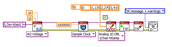

I've got some simple problem that I can't resolve.
What can possibly be wrong in this VI ?
I have much larger application but my USB- 6361 didn't want to output a signal so I wanted to see what can cause it. When building output function from scratch I came very soon to this state and it doesn't put out anything. ( Simple Output Application: Create + Write (Autostart True) + Clear is working well ).
It is very suprising to me as I made some more complicated application in past using DAQmx and it was working preety well.
(3,976 Views)
Accepted by topic author Dide_
I found what was the problem. Clear function killed task before it send anything 🙂
