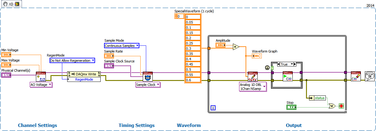

I try to program my DAQmx device. I have an array of double (custom waveform), a variable amplitude depending a other operation (feedback), frequency of 50Hz. I want to change the waveform between to cycle with the new amplitude.
I have error like:
Error -200288 occurred at DAQmx Write (Analog 1D DBL 1Chan NSamp).vi:1780001
Possible reason(s):
Attempted to write a sample beyond the final sample generated. The generation has stopped, therefore the sample specified by the combination of position and offset will never be available.
Specify a position and offset which selects a sample up to, but not beyond, the final sample generated. The final sample generated can be determined by querying the total samples generated after a generation has stopped.
Attempted to Write Sample: 40
Property: RelativeTo
Corresponding Value: Current Write Position
Property: Offset
Corresponding Value: 0
Task Name: _unnamedTask<28>
How I can do it?
Thank

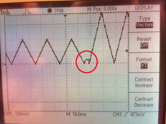

This is working, but take around 6 second before updatingAnalogOut_WithAplitudeFeedback_2.png
(5,157 Views)
and the update need to be at the end of cycle...

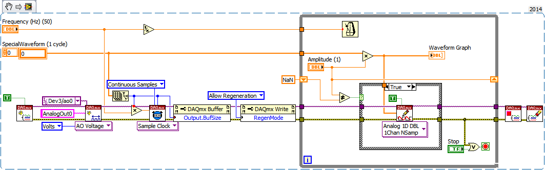

I toke
https://decibel.ni.com/content/docs/DOC-25373
and modifiy a litle bit and this's working!
