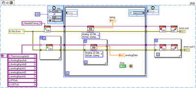

Below is a representative sample example of the code that I am dealing with.  The example uses the Timed Loop but a While Loop with or without a delay generates the same error message:
Error -200279 occurred at Untitled 1
Possible reason(s):
The application is not able to keep up with the hardware acquisition.
Increasing the buffer size, reading the data more frequently, or specifying a fixed number of samples to read instead of reading all available samples might correct the problem.
Property: RelativeTo
Corresponding Value: Current Read Position
Property: Offset
Corresponding Value: 0
Task Name: LVDTsA
Code snippet:

It would be best to read 100ms worth of samples for every call of DAQmx read than leave it to read whatever is available.
In the task, increase your samples to read so that the samples have a large enough buffer to keep up with capture and not overflow. The biggest red flag I see is the LVDT, Load cell task that read 1kS/s but samples to read is just 10 but you read it only every 100ms, it does not match up quite.
Increate your samples to read to 1s worth of samples and ask for 100ms worth of samples for every call of DAQmx read and could ditch the timed loop too as your samples are hardware-timed, it would be near perfect (dependent on actual sampling rate).

I think some combo of things Santhosh and I have said should help get you there.
1. To me, the biggest red flag *BY FAR* is the choice of N Channel 1 Sample reads.  You'd be much better off reading multiple samples per read call such as the 100 msec worth suggested by Santhosh.
2. I checked specs on a few of your devices and they do indeed have a variety of sample rate constraints.  So I'd urge you to do like the shipping examples and *QUERY* the actual sample rate after the call to configure DAQmx Timing.  Then use 1/10 of that as the # of samples to read per WHILE loop with no other delays in the loop.
3. If you put another delay in the While loop (or use a Timed Loop) you risk the timing overconstraint I mentioned before.  DAQmx Read alone can handle the loop timing.  (Again, compare to the shipping examples for continuous acquisition that let DAQmx Read pace their loops.)
4. Because you're dedicating a separate loop for each task, I'd agree with Santhosh that the method above is preferable to the one I described in msg #6 where you'd periodically request "all available samples".  That other method would be for cases where you serviced multiple tasks of different rates in a single loop.
5. I never really define tasks in MAX so I don't know what to make of the "Samples to Read" parameter there.  Because when the code makes its actual execution-time call to DAQmx Read, there's an input terminal for the # samples to read and a default value/behavior defined when you don't wire it.  Either way, it seems to me that the code value's gonna win out and that the MAX value is actually meaningless.
    Maybe the MAX value is supposed to be a buffer size suggestion?  (As to why I call it a suggestion rather than a definition, see further explanation here and then also my partly related gripe/suggestion about it).   But it's conceivable to me that the rules at the links don't apply the same way to a MAX task as they would in a call to DAQmx Timing.  In case that's true, you should make those buffers considerably bigger.  I'd want buffers of at least 1 second and I personally tend to make 5-10 second buffers more often than not.  We're still talking total memory in the single digits of MB probably.
-Kevin P
