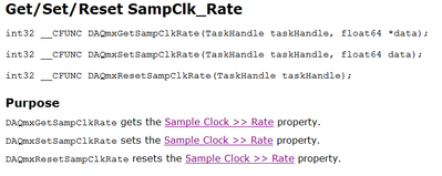

Use DAQmxGetSampClkRate to get the actual sampling rate.ZYOng_0-1679340276672.pngZYOng_0-1679340276672.png

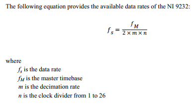

Thank you, ZYOng, for your answer. Actually I'm not really referring to the sampling rate, but to the oversampling rate of the delta-sigma converter.
The datasheet of the 9232 module describes:

// decimationFactor = 2 x decimatinRate x clockDivider, clockDivider is in [1, 26] (cf. 9232 datasheet)

// now find a decimation rate that fulfills samplingRate = baseRate / (2 x decimationRate x clockDivider)

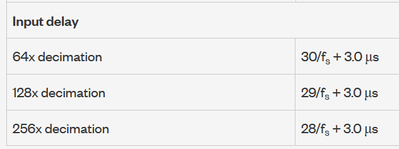

I need the decimation rate to determine the input delay:
Cf. https://www.ni.com/docs/de-DE/bundle/ni-9232-specs/page/overview.html:
