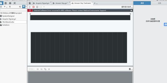

ERROR ABOUT THE ANALOG INPUT
when i create a task for analog input, the configuration pane is missing and an error says the INTERNET SOFTWARE ERROR OCCURRED IN MIG SOFTWARE.

I strongly hate this error. The information doesn't give us any detail : (
Have you installed the latest DAQmx driver? Other workarounds are here.
DAQmx Start Task Error -229771: Internal Software Error Occurred In Mig Software

Thanks a lot!
Labview NXG may no fit my computer,  now i use Labview, that works better.
