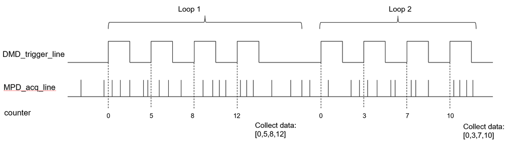

Here I draw an illustration to show what I try to do. I hope it is clear. DMD_trigger_line is the sample clock and MPD_acq_line is the digital input to be counted.
I guess continuous sampling would be a good idea, but I'm not sure if I can read the data in the loop again and again. Then it would be great.
Here I reset the counter value just to mean that I don't care about the data between iterations. In fact, I will calculate the difference, e.g., [5,3,4] for the first loop and [3,4,3] for the second one.
Thank you in advance!

Still not fully clear on all the details.  If you expect DMD_trigger_line pulses to come in groups of 65, without really long intervals from the end of one group to the start of the next, you very much should be able to configure your edge counting task for continuous sampling, start the task just once before the loop, perform reads of 65 samples each iteration of the loop, and then end the task just once after the loop is done iterating.
There are also ways to configure the counter so that the differences you care about are captured directly in the hardware.  Namely, you could do period measurement with units of "Ticks".  This is a bit more of an advanced usage which requires non-standard configuration and a little bit of "inside out" thinking about the role played by your signals in the counter task.  It's probably unnecessary for you this time around, but can be worth being aware of as another option.

Thank you so much for your advice! I configure it to continuous sampling and now the time is as expected. I didn't find a way to capture the differences directly but it's fine. Maybe I will look into it when I deal with larger data.
