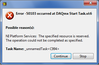

I'm using the attached VI to control a stepper motor that works flawlessly under LV2010 but starts throwing error (image below) when used under LV2012. If anyone has an idea please help.. 😞  - Thanks!
Note that I've DAQ assistant is configured properly.

This error occurs when you are trying to use the same hardware resource for more than one task or route.  I took a look at your code and noticed that your Fast Move Express VI is set to run continuously, which means that once you start it, it will repeatedly output your 100 sample pulse train until you wire a TRUE into the stop input terminal of an Express VI .  This is reserving your board's counters without freeing them up, and I also imagine that the continuous behavior is not what you intended.

I'm not using the same hardware resource for more than one task. In fact, I tried to configure the Fast Move Express VI to a different hardware (USB 6259) alone (same PC) but the same issue occurs. The thing I've noticed is this VI works on WinXP with LV2010 & LV 8.6. Now that the machines OS is upgraded to Win7 + latest LV version it stops working. but I really hate to downgrade.

Sometimes the way different OS's and CPU architectures handle concurrency can vary greatly; this can affect application behavior when parallel threads are running without proper use of concurrent mechanisms such as semaphores and resource management.
Your Fast Move Express VI asynchronously spawns a separate thread when it is called in order to output your counter task.  Each loop iteration spawns a new thread running a continuous counter output task, which has to reserve a counter on your board.  In my testing of your code, the Fast Move Express VI would execute twice (reserving counter 0 and then counter 1) and error out on the third iteration after both counters were reserved.  Setting the Express VI to N Pulses instead of Continuous allows the resource to be released after 100 pulses are output, which I presume to be the intended behavior.

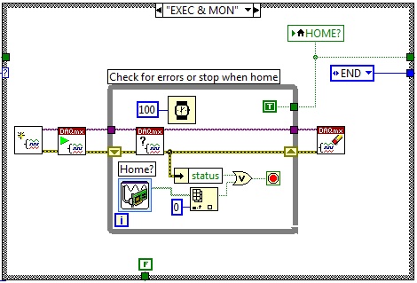

Express VIs generally are not designed for this kind of use because they open and close a session every time you call one.  This should result a in a glitch in your output like you were seeing.  To be honest, I am quite surprised you were not seeing this non-smooth behavior before with your implementation on Windows XP, and I don't have a good explanation for why it worked.  I can, however, recommend a more robust approach to generating this smooth output you are looking for.
If the goal is to only move once per INIT (e.g. once you start moving, don't stop until you're finished, at which point the VI returns to the INIT state), you should convert your Express VI to DAQmx code (right-click»Generate NI-DAQmx Code).  And try an implementation similar to this in your EXEC & MON case.  This should produce the desired behavior.

Chris,
It worked like a charm...
Thank you very much.
