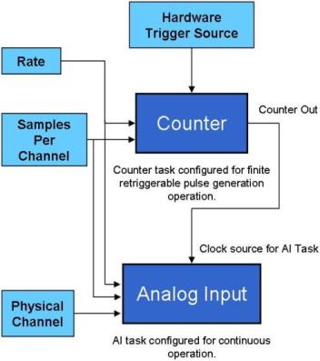

Yes you may do this using the implementation described in the tutorial that was linked above:
The counter output is retriggerable, generating 10 pusles per trigger.  The analog input is continuous.
