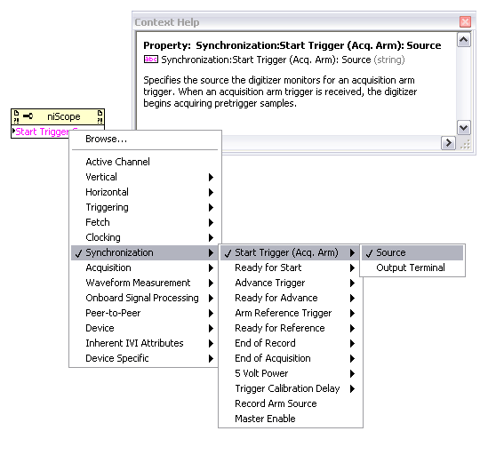

Hi chsl,
It sounds like the scanner might just be running continuously and you only want to trigger an acquisition at certain times.  If this is the case, you can use a Start Trigger with the 5105:
