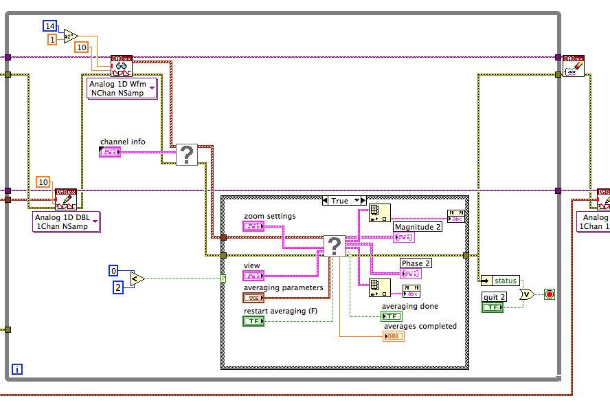

Hi, I'm using a piezoelectric stack  to generate some ultrasound in water to caluclating maximum pressure inside the beaker i'm using, for that i'm using labview Spectrum analysis(FFT) to find the resonance peak. first i'm sending uniform white noise to check where the maximum harmonic  i got  then at  that frequency i'm sending sinewave to get the resonace peak. that what i'm trying to do, but when i send white noise and , sine there is no difference in the FFT spectrum is anything wrong in my vi?

Some of the default settings on your VI are inconsistent with your description. Sine wave signal rather than noise for example. And the sample rates being different on the DAQmx VIs and the SV Signal Generation VI.
I cleaned up the diagram on your VI. With crooked wires, wires behind other objects, right to left wires, and other issues, it is very difficult to determine what the VI is supposed to do.

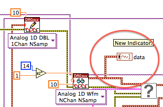

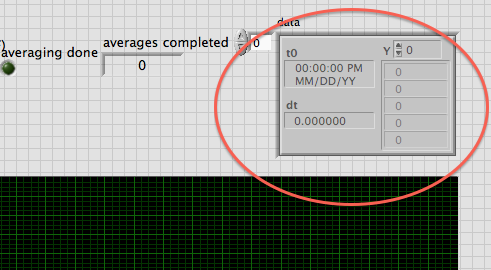

That has defalut setting for the controls but no data. Actually your VI does not have an indicatro where I would like the data. Right click on the data output of the DAQmx Read inside the loop and select Create Indicator.

Run the VI until some tyipcal data is in that indicator. Stop the VI. Right click on the new data indicator and select Make Current Value Default.
Save the VI (probably with a different name) and post that.
Then the VI will have one iteration of raw data from the DAQmx Read so that I can see what is going on.
