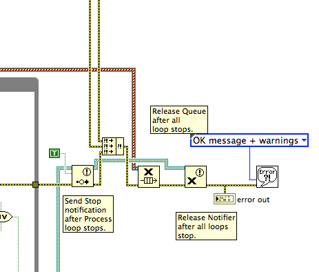

I think this may occur on the last iteration. The queue is released before the loop receives the stop notfication. The error is due to an invalid queue reference - after the queue is released the reference is no longer valid.
Try re-arranging the Send Notification and Release Queue as shown here.
Lynn

Hi I made a changes what you said and now we have a new error at DAQ Read we have an error 200279 and at DAQ write we have 200016
