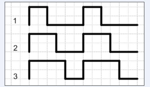

The waveforms are actually with the same frequencies, but different duty cycles, as you can see from the picture below. However I need the duty cycles to be adjustable so that I can adjust them during my measurements.

OK, so I may be mistaken, but after mucking around for a bit, I realized that the regeneration ought to be automatic - that is, if you right a pattern and then just let your VI run in a while loop, you will find that the generation is continuous.  Check out the Correlated Dig Write with Counter in the Labview example finder.  You can exploit this such that you get the duty cycle you are looking for.  You can divide down the signal such that you write a single period consisting of a series of 0's and 1's.  That is, if you want a 100 kHz wave with a 20% duty cycle, you write a digital waveform pattern a 1100000000 at a rate of 1MHz.  Using this technique, the resolution of the duty cycle will be limited by the onboard clock speed (80 MHz = 0.125%).
