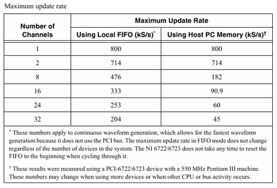

Unfortunately, both PXI-6723 and PXI-6515 do not support hardware-timed digital output.
However, PXI-6723 does support hardware-timed analog output. You can do two channels up to 700kHz or 8 channels up to 100kHz for baud rate. I would recommend starting with the example C:\Users\Public\Documents\National Instruments\NI-DAQ\Examples\DAQmx ANSI C\Analog Out\Generate Voltage\Mult Volt Updates-Int Clk
