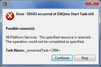

How can I fix 50103 Error..
When I run VI, everytime Error masage is poped up..

I cant look at your VI but have you searched the board for that error code or message? Typically, the error is caused by trying to use more than one task for a single resource. Create a single task that uses multiple channels.

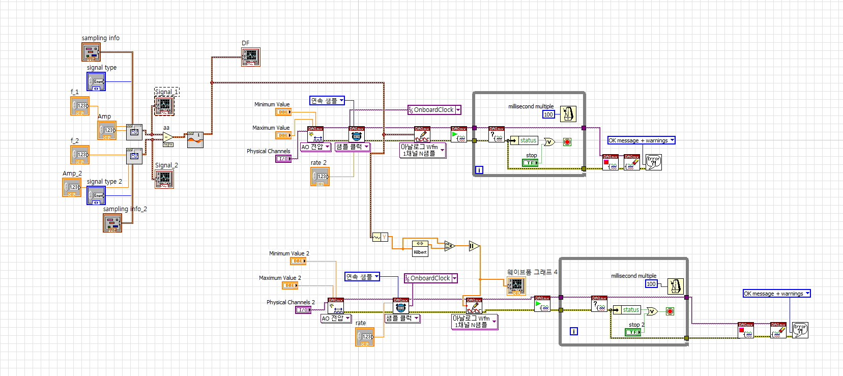

Exactly, I wanna get two output analog signal but I couldn't..
one is the Difference frequency signal and another one is Envelope signal of DF using hilbert transform.

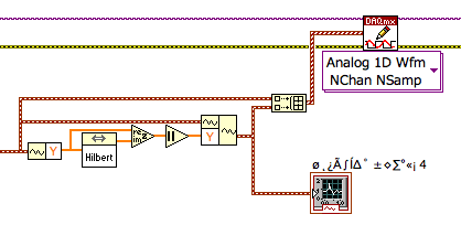

I think you can specifiy multiple channels by using something like "Dev1/ao0:1" in one of the Physical Channels controls. Then combine the data into an array of waveforms or a 2D array of DBL. Change the DAQmx Write to NChan NSamp, either waveform or array, depending on which datatype you chose.  Look at the detailed help files for the DAQmx VIs to determine the exact format for the physical channels and other details.
Of course you will only have one set of DAQ VIs in place of the two sets you now have.
