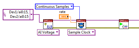

Unless you need different channel settings (e.g. voltage ranges), you don't necessarily have to call multiple instances of DAQmx Create Channel.  Something like this would work too:
